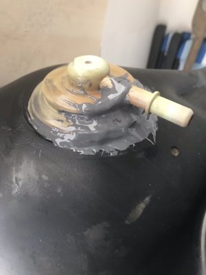

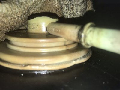

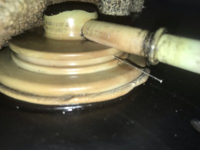

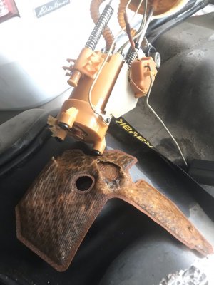

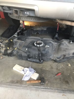

I have just dropped and replaced my fuel tank. I had a front of tank leak with a gas smell for some time. Finally dropping the tank was prompted by an increasingly frequent stall which was becoming hazardous. I put it down to a failing fuel pump. So I dropped the tank, with 17 gallons of fuel in it (avoid this if at all possible) using a transmission jack and plywood fixed to it. I didn’t realize there’s really no easy way of getting fuel out of this tank without removing the fuel pump and syphoning it out of the hole. Anyways, the pump filter/sock had rotted off so I changed the pump and also the inline filter, and epoxied the crack in the front plastic-welded fitting on the top of the tank and put it back up. Good news is that it still works, bad news is I still have the random and increasingly frequent stall. I’m now going to pull the fuse box and change the R303 relay...
For others info I’m attaching a few photos in case they are useful. The pin in one photo is to show the crack that is the source of the leak. Getting the fuel filler hose off the tank needed a Dremel to cut the hose clamp (fun times) and getting it off and on was really tough. Removing and replacing the vent hose above the tank is awkward as there’s little play but the clamp was clocked such that I could get a 7mm ratchet on to it easily. Overall I wouldn’t class this as an easy job compared to most others I’ve done on this vehicle and it has some inherent dangers of course lol.8454CC52-A02A-4B11-8103-23547E85531E.jpeg354FF6FE-64FD-47CA-B901-ADCE1E17C884.jpeg39DA8F12-C167-4475-B3C5-C39A5EF97C6F.jpegDE37FB10-864B-45A8-AF42-2CD032A7F42A.jpeg

@texasscot That is Extremely helpful! Thank you!! Even after the replacement and a new pump, mine is still leaking. With your pictures, I feel much better about understanding what to do to "fix" it myself this time instead of paying another mechanic to do it wrong. :)

Two more photos that may not have relevance to your situation but they show the special tools I used to carefully remove the pump retaining ring (piece of 2*4 and club hammer) and the deteriorated pump filter.

Sorry to revive an older thread, but what kind of epoxy did you use on that, @texasscot ?

Plastic welding to repair it is the way to go. HDPE plastic is very difficult to repair with adhesive as most just don't stick well.
