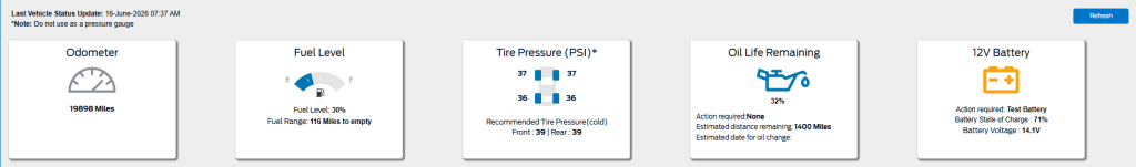

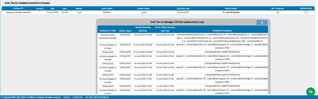

It's the 12v battery. SoC is being reported at 54% and battery capacity is also low at 31. Not sure if these trucks bring an H6 or an H7, but capactiy of an H6 tops at at 70 and an H7 os 80, so 31 is low either way. I would recommend you charge the 12v battery fully to 100% and try to install the update manually as soon as the battery is topped off.

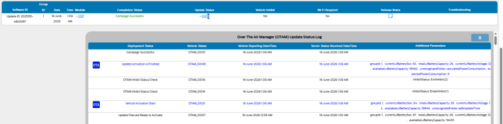

Do you have this graphic larger so I can read it? The copy posted is blurry.

PS: Does this chart say anything about the battery's health. Do I need a battery, or was it simply not fully charged?

It's impossible to diagnose a batter remotely, but based on what your connected data shows, you battery needs to be tested and possibly replaced.
I see the OTA installed, but the battery SoC and capacity are still very low. If the battery in your truck is the same one it was built with, then it is probably time to replace it. It would need to be tested on the machine that tests all the cells; not the qucik test that gives you a read out in a minute. I would just replace it. These OEM batteries are garbage.
