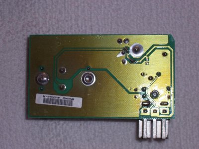

The Electronic Automatic Temperature Control (EATC) uses a Blower Control Module (BCM) to control the fan speed as opposed to the resistor coils used on the manual systems. This provides the many fan speeds controlled by the thumbwheel on the control panel as opposed to the four speeds provided by the rotary switch on the manual versions. The module is mounted in the hvac box, in the airstream, with a large heatsink and circuit board inside, and the electrical connectors on the outside. These modules have been troublesome on the "panther" cars (Crown Vic/Grand Marquis), causing intermittent blower operation. The cause is incomplete solder connections on the circuit board. Tapping on the module with the butt-end of a screwdriver will sometimes temporarily restore operation. Replacement "new" modules wil be affected the same way as it is a manufacturing defect. The permanent fix is to resolder the wire connection points on the circuit board. You will have to find where the module is located on the HVAC box in the Expedition. On the panther cars, it is on the A/C plenum under the hood on the firewall. The photo of the circuit board shows the burned solder joint on one of the large pins. When these are acting up and arcing, you will actually get a burning electrical smell from the vents inside the vehicle.
