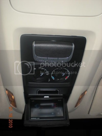

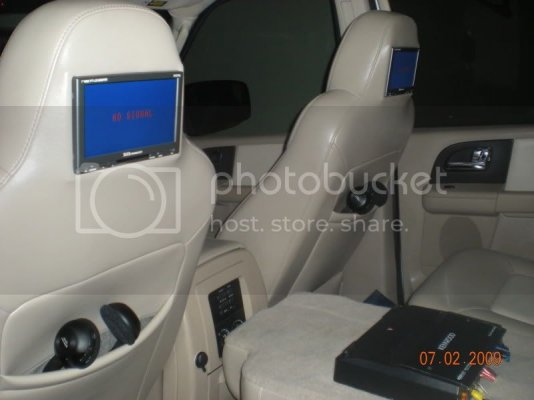

IF YOU GO WITH A PROBOX (HAD MINE FOR 1O YEARS THIS DECEMBER) AND 2 10'S IT FITS PERFECTLY! AND SOUNDS AWESOME AND LEAVES YOU ROOM FOR A MILK CRATE ON EACH SIDE, THE ONLY ISSUE IS WHERE TO MOUNT YOUR AMP. I MOUNTED MINE ON MY 2ND ROW MIDDLE SEAT. OTHER THAN THAT I KNOW THEY MAKE DOWNFIRE STYLE BEHIND THE THIRD ROW BOXES BUT THERE THE PARTCLE BOARD AND CARPET BOXES. AS FAR AS THE IN DASH NAV I WOULD RECCOMEND SAVING A FEW HUNDRED DOLLARS AND GETTING A GARMIN AND MOUNTING IT IN THE OVERHEAD CONSOLE, THE SCRENS FROM THE ROOF IS COOL BUT THE AC STUFF IS UP THERE AND CAN BE A PITA TO WORK AROUND I JUST PUT MINE IN THE HEADREST OR SHOULD I SAY BACKRESTS LOL, IF YOU HAVE KIDS THEY CAN WATCH IT WITHOUT HAVING NECK PAIN....LOL ( I HAVE A 2 YR OLD AND A 4YR OLD) HERES SOME PICS OF MY SETUP HOPE IT HELPS.......

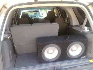

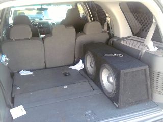

i have two 12's in a box behind 3rd row. amp is installed on back of box. usually have box turned sideways over the small half of third row with third row down. have plenty of room. will post pics soon
tallsville
Jul 10, 2009
3,174
169
LA
here is what my subs look like. its easy to remove box if you need to get large items into expy. just tuck wires on side of 3rd row. i have a pioneer head unit and a 1000w amp with a bass/power control knob on dash.

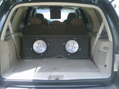

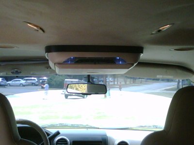

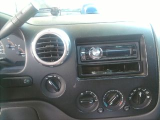

i have 2 12's...kicker cvr's...boss 15 inch flipdown with built-in dvd with 2 wireless headphones and pioneer nav/dvd/bluetooth/touch-screen w/remote head unit...AVIC-D3...here are the pics...
you can see the touch-screen in the last pic
