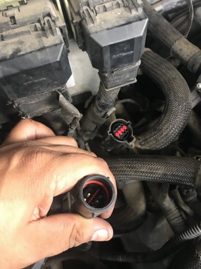

Hello I have recently purchased my 2nd expedition it’s a 06 king ranch it’s a really nice vehicle and ride,but I’m having some transmission blues. It’s not shifting into 3rd with overdrive on I have replaced the od accumulator(wasn’t broken) the 2-3 accumulator and put a rebuilt valve body on. Has good fluid level but still having the same problems. I’m trying to eliminate every possible issue before I pull it out for a rebuild. While looking for wiring issues I found this connector chewed up anyone know where these go or have a wiring diagram for it?
