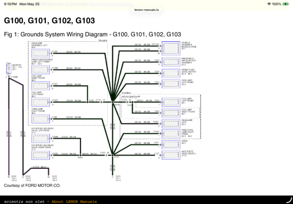

If neither high or dip are working, I would suspect a problem with the ground wire. I would be checking that it makes good contact with the negative battery terminal. Measure the resistance from the black wire at the bulb connector to the battery negative terminal, if more than a couple of ohms, you need to find the break or bad contact.

The drawing shows two splices in the ground wire on your light circuit. Splice 129 and then splice 131 then ground at G 103.
Here are a couple drawings, the first is what is grounded at each splice. The Navigator portion is on the left side and the Expedition is in the lower right side. The second drawing is approximately where under the hood the two splices are and the ground location. I would look for corrosion at the first splice 129. My Navigator actually had a wire fail inside the splice for a window circuit.
