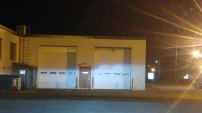

I wanted to give everybody that followed this thread an update.
I installed my 55W HIDs into the factory projectors today. They came out really great, much brighter than the LEDs that I had put in with more penetration. Funny because the LEDs were 60W 6000 lumens each and 6000K color the HIDS are 55W 4200 lumens and 5000K color.
This picture is parked about 25 feet from a building on flat ground. I am very happy with the beam pattern and it has a great cutoff. I think that I can raise the right one just a little more and still be good. I took this one with my wife's cell phone and it doesn't have the greatest camera.

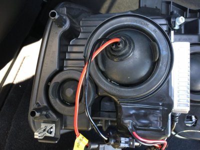

I should have taken pictures while I had them out. It was cold here yesterday and I was trying to get them done before I lost the sun which was giving a little warmth. I recommend going with the xenonhids.com and getting their galaxy 55W ballast for whatever bulb that you need for your F150. The installation was fairly easy. I had to cut a 1" diameter hole in the rubber cap to accept the rubber grommet that comes with the harness. I found a great spot on the back of the headlight housing on the side of where the projector bump out sticks out next to the access to the high beam bulb. I had to cut a small opening in the case to pass some of the other connectors and wires through. I sealed that opening with several layers of high quality electrical tape that I layered like shingles so that any water that gets kicked up sheds off.
It took less time to do all of that than it took to type. If I have reason to remove the assemblies, I will take pictures.
Updated 3/16/17
These are pictures of my installation. I've decided to replace the low beam dust covers and route the wires out through the same opening as the red and black wires that are coming out in the area with the black tape.

Are you SURE you have a projector in there?
Cuz it sure looks like the two super-bright glarey fireballs in the middle AND the lack of any clear cutoff line that you get from illegally putting HID in halogen reflector housings...

Reflectors = great big balls of fire in middle, scatter light in all direction....see your pic and @Habibie 's. Also...ILLEGAL and kinda dangerousm
Projectors, even cheapie ones = straight line cutoff, like in my pics or @gixer2000 's example, with a little colour cascade effect along the cutoff line

Very sure. Look a the middle picture in my sig.

Well Adieu you are wrong there, they are the stock factory projectors and the halogens made the same pattern. They aren't illegal here and nobody has flashed their lights at me.

These are the Ford projectors that come with the vehicle. I will post HID pics tonight after it gets dark.
Halogens
LEDs
I will post the hid pics right here tonight after it gets dark.
The beam pattern of the halogens and the HIDs are very similar. The LEDs are diffused but don't project very far and are noticeably darker or dimmer when driving.
