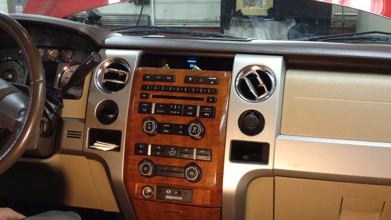

Ok so this driving me nuts. I have a blend door/gate issue that I have not been able to diagnose but this is a new problem.
I have the dual climate control and both sides are set as cold as possible (60 deg F or 16 deg C) and the drivers side blows cold and the passengers side blows HOT no matter what I do.
Any suggestions on what is going on here? See photo for visual.
Thanks

Without more info, I would guess the blend door actuator behind the radio is the culprit. Any clicking noises? If this is the issue Ford will charge you 10 hours labor for the repair, but you can do it in 1.
Part is $37 from Amazon.
