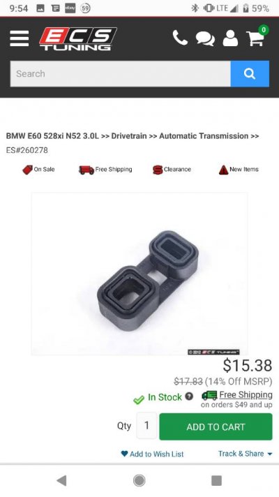

I believe I have found the culprit to the 2-1 bump shift on the 2007-2008 expeditions and navigators that use the zf 6hp26 transmission. It seems the mechatronic sleeves crack/wear and it causes the issue. The main sleeve/ seal and the 4 other tubular seals should cost under $100 and are fairly easy to change when you drop the pan.
The issue is that I cannot find the parts to replace them. BMW uses the same transmission in a large number of vehicles and I am thinking the parts will be the same but I am not sure. Does anyone have access to these parts or know of a shop that would? 1cdec23622c148acc1bb278dbba9f08e.jpg

Thank you Stamp. I am able to find the parts for other vehicles as you posted. The main issue is finding anything saying it's compatible with my Lincoln. I assume it is since they should be the same transmission. Just trying to make sure I have the correct parts when I drop the pan! That pan gasket looks identical to the one Ford sells for $55-80. Good deal at this website for $25!

The parts I used l worked great but it didn't fix the 2-1 bump. From what I read it's gotta be the solenoids themselves.
