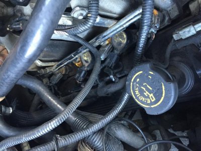

Welcome to the forum! I had the same exact problem about a week ago. I stared searching the threads here and a lot of them were talking about the coil packs that sit on top of your spark plugs. They tend to go out. Mine did not have any CEL come on or anything. It just started having the same symptoms that you described. I myself am just starting to be a diy type of guy too. I didn't know how to check which coil was bad. So I started checking all the connections first, which everyone seemed fine. Then I just started to take out every coil to check them out. Until I found one that looked pretty beat up and actually shorter than the other ones. I switched that one out and ****!!! Problem fixed. I'm going to attach a picture of the old and new coil pack. I will also attach one of where it came out of. I still don't know the order of the Sparks plugs/coils. All I know is that there are 8 lol -___-
Hope this helps in any way.

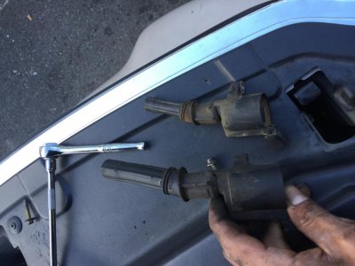

Here's the other picture of where it came out. If you are standing in front of you truck looking at the engine. It's the left side(passenger) of the engine. 3rd plug going front front of car to firewall. Hope that helps explain.

Try taking the coils out one at a time and inspecting them. The coil itself is held in by one 7mm bolt. Then You have to disconnect the connector to the coil. There is a little tab on the bottom side of the connector that u squeeze in order to pull. And that's it. You pull out the coil carefully, and inspect them. That's how I found my problem.
