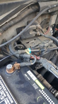

I removed the vacuum line going from the check valve to the cabin.
Put a vacuum gage on the check valve and shut off engine.
No loss of vacuum. Tells me I am good at the engine bay.
S
snb73
Mar 28, 2005
Waldorf, MD
Checked the Vacuum line going through the firewall.
Found an abrasion right at the connector.
Cut off the bad piece with a razor blade and installed a new adaptor. $4.95 for an assortment at Auto zone.
Tested switch and everything worked fine.

Hey, All. I just want to say thanks for posting this. As Brian said, someone else will learn.
My son-in-law has a 2003 Expo that had the same symptoms. I sent him these pics and he found a disconnected vacuum line near the check valve. Connected the hose and violà! Ice cold again! Good thing, too since it's going to be over 100° for the rest of the week here in north central Utah.
