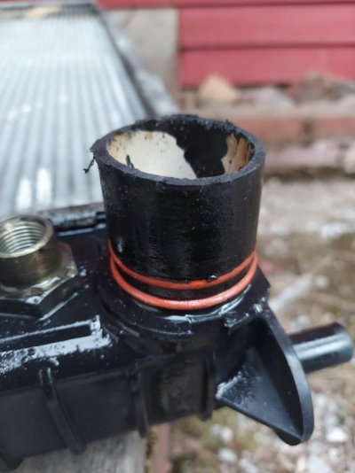

"I'm replacing the radiator on my 2001 Ford Expedition 4x4 with a 5.4L engine. The new radiator and OEM hose didn't come with new O-rings, which are visible on the old radiator in the attached picture.
Does anyone know the part number for these O-rings? I've tried a few different ones, but they don't sit flush like the original. I've also checked with several radiator and hose suppliers, and none of them have the part or can find it in their systems."thumbnail.jpg
The original OEM hose has a connector on the end that directly connects to the OEM radiator.
(1/4 turn lock) no external o rings or clamps needed.

The picture that I uploaded was the original radiator and it has the two red o rings. I purchased the original hose and it did not have o rings and as you discribed it. The OEM radiator that I purchased has two groves for two o rings. I could reuse the two o rings from the original radiator but I prefer to replace them with two new ones.
