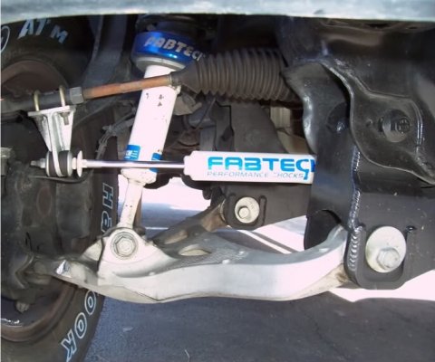

First off, thank you in advance.
I've been hunting for a steering stabilizer for my Expo but cannot locate a kit readily made and manufactured for her.
Has anyone successfully used a kit from say, an F-150 or Super Duty or any other vehicle for that matter?
If so, what kit?

I think j your best get is getting some kind of kit for the F-150 (04+) and just fabbing it to fit the expedition.
Looks something like this...
Also I think the question needing to be asked is why do you need steering stabilizers on your 2wd Expy?

Thank you for the picture and advice.
I want to put SS's on my Expy because I am running oversized tires and the fact that in most cases when there is a front tire blow-out, the vehicles first response is to veer hard in the direction of the blown tire.
The steering stabilizer is the most effective way to deal with that contingency.
Would it please be possible to get a picture of the other mount that is not visible in the above picture?

Ok that makes sense!
But no I'm afraid the forum I took that pic of the F150 from only had the front view pic... But if you go online and see the fabtech stabilizers come with only a couple bolts and 2 brackets so I imagine it's very simple and easy to put them on the F150 and shouldn't be too bad to get them on an expy? Once again I don't even know if this have ever been done but I don't see why not?
