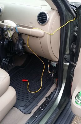

I took a small paper clamp, removed one of the silver finger tabs and shaped it to fit inside the plug of the DG/YE plug itself. (https://cdnimg.webstaurantstore.com/images/products/medium/234014/1258245.jpg)

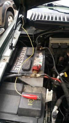

Once I had pushed my test clip in I then clipped one of the alligator clips to it and then exposed some of the insulation of the hot lead coming off a cigarette lighter plug from an accessory and clipped the other end of the test lead to it. She cranked and tried momentarily to start but didn't. I then figured that the plug needed to be plugged into the fuse box to complete some kind of circuit for the PCM or ??
I plugged it back into the fuse box with the test lead still attached and gave her a crank.
VAAAROOOOM! SUCCESS!
She idled just fine and I didn't have any fires or explosions :)
I had just verified that the pump was good, the relay was bad AND found a way to get myself home all in one fell swoop.
I burned up two cigarette lighter adapters on the way home due to both the distance from home as well as the amount of voltage being drawn through too small of gauge wire for the adapters but at least I wasn't stuck in the middle of downtown Dallas over-night, didn't have to call a tow or leave her behind and come back to a, most-likely broken into Expo.

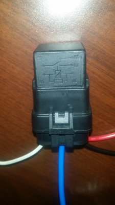

Replacing that fuel pump relay is not an easy task as it requires completely uninstalling the entire fuse box, then carefully dismantling/opening the 'clam-shell' design, then de-soldering the OEM relay, soldering in the replacement relay then reassembly and finished off with re-installation into the truck.
I've decided to use a standard but HEAVY DUTY relay, powered off a switched lead to bypass the OEM relay but also, install a hidden toggle switch so I can essentially use this re-engineered design as an anti-theft device.

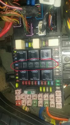

doesn't the fuel pump relay just unplug from the CJB? I have never seen one that didn't
Apparently for this year Expo, there were two designs. One of which is the clamshell where some relays are INSIDE and UNDER the visible set of relays and fuses that are easily serviceable.

Added a picture showing how they are between and below the easily serviceable relays.
Here's a YouTube vid that shows the uninstalled board with the soldered on relays.

So, after getting 100 miles to half a tank of gas, I realized the PCM is not just sending power to the relay but controlling the voltage therefore controlling the amount of fuel being supplied.
Now I'm wondering this. Could I just add a potentiometer like this one LINK to the circuit that would allow manual voltage control for low need scenarios such as surface street driving or stop and go traffic?

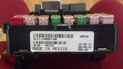

If you decide to replace the fuse box be careful Ford used two different fuse boxes in 2003 they are not interchangeable the replacement must have the same part number as the original
the complete part number is a combination of 12 numbers and letters
4 then 6 then 2 not just the 6 in the middle see the attached as an example
