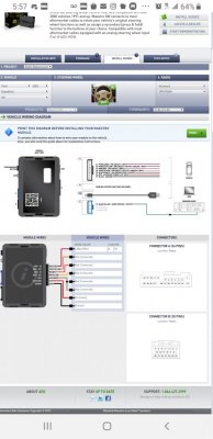

Now my truck is an "early" model 2003 unit which seems to have some different wiring but this in theory should work for everyone. My truck had the regular cd stereo with the factory DVD player...which I'm working on. Anyways here is the idatalink setup screen for my truck
https://photos.app.goo.gl/svJQYR1H4VuzmYj78

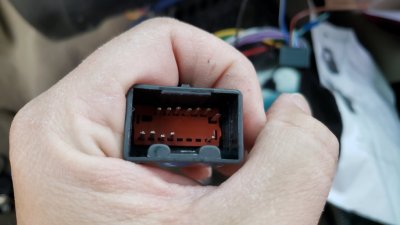

Now the Idatalink I stall guide says i am to use the larger 24 pin connector they labeled "A" and i want pin 18. This is wrong. You wanna use the connector theu have labeled "B".

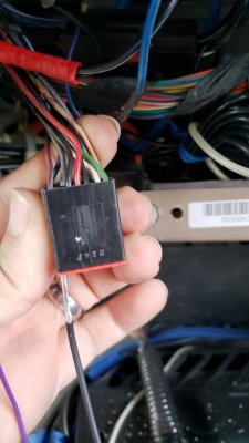

This is the pin you want...i inserted the pin into the correct plug as you can see here

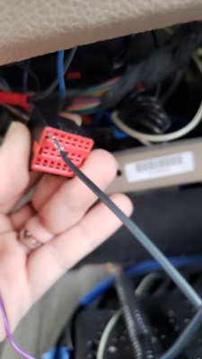

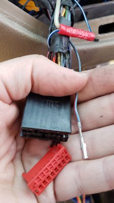

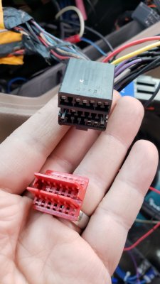

Now once I found the correct pin i went ahead and started modding things to make my life easier. I removed the locking plate from the factory plug and pulled out that single pin.
You remove the locking plate with a small flat blade screw driver pushing up on the tabs on each side of the black plug housing, once the pin is out replace the locking plate

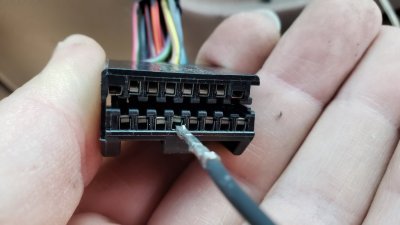

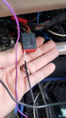

Now that the pin is free I decided to make my life easy here. I added that newly removed pin to the other factory plug that your stereo wiring harness plugs into, you will have ONE open port to insert the pin into. Again removing the red locking plate and inserting the pin into the plug. Once inserted replace the res locking plate

Now that the pin is moved over you will take the stereo wiring adaptor harness that you buy with your head unit and you will see this plug

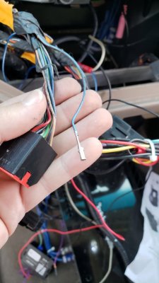

Well when I bought the stereo i also picked up a second harness kit that I found doesnt work. So i pulled a pinned wire out of it and added it to the wiring harness adapter as seen here it is blue with a white stripe.

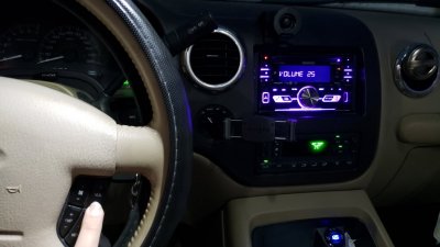

Now according to Maestro SW install guide all is done and it's time to test. It.
Volume up
https://photos.app.goo.gl/DMEqWwayTmjzfvLKA
Volume down
https://photos.app.goo.gl/Lfn2dw8qjWE2i2VS7
Volume up
Volume down
