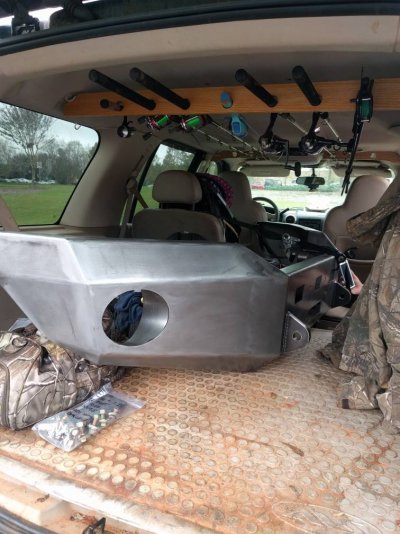

Very cool, Scoot!! So nice to be able to just drive down and pick it up! Can't wait to see what you end up doing to it and seeing it on your Expedition!
BTW that's a very cool pole rack you've got going there! You can probably market that and get a side business going :).

Yeah WAM is only like a 1hr and 35 minutes drive South of me so it was nice.
Natalie was very nice and helpful with additional information . And she was a Hottie ;)
Yeah I can't wait either but gotta get the Winch and Bedliner spray. Then get it mounted and c if I still wanna trim the lower outter corners on the bottom..
Thanks and I'll post pictures when that time comes..

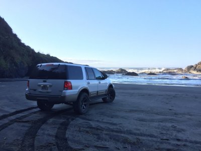

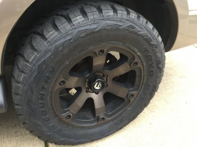

Drove out to the beach on Sunday to check out a new beach access area. Still getting a body vibe that seemed to get worse with time so decided to take her in for yet another road force balance on Monday. The shop was getting close to closing time so the guy asked about the shake. I told him about the previous balance attempt and how the driver side, rear tire had something wrong with it and how they repositioned the tire on the wheel. They focused on the rear tires and low and behold they discovered the driver side rear could no longer be balanced! So they gave me a new tire!
Long Beach, WA.
... and my new tire! Drives soooo much better!!

It is really great when a shop stands behind their products and their work.

Couldn't agree more. I was really hoping they would replace it because that left rear tire was suspect for a while so when I saw them pulling the old tire off the wheel with a new one on the floor right next to it I started smiling :).

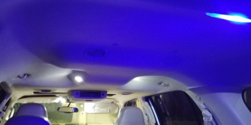

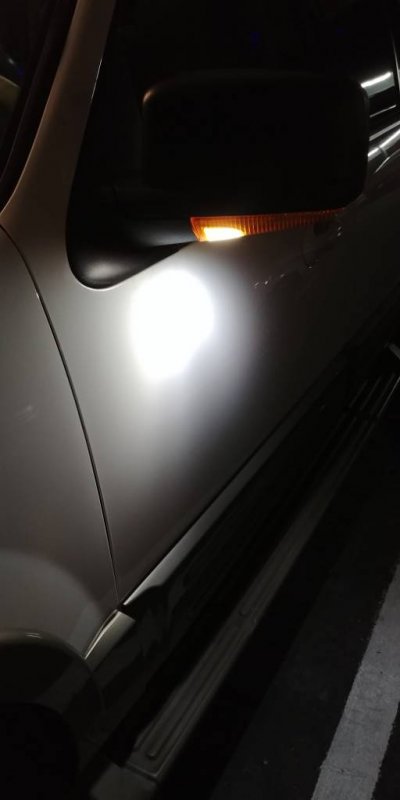

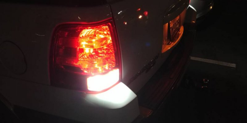

I went nutty with the LEDs....
Blue in the rear cabin, amber licence plate and front and mirror turn signal, bright white everywhere elseb623c5c9b82932a2b1216270918acb61.jpg50cd48cbe29d7c130a3b27fe3c17ee7b.jpg45e50f354fb3b800c50904272da4d52f.jpg
Sent from my LG-H872 using Tapatalk
If you want to have good visibility out the back, high-powered white LICENSE PLATE lights are a must....
Its sounds odd but they really light it all up

Is that thing gonna stay on OK???
Looks heavy.... and stock bumper mounts are amazingly flimsy, properly intentionally so

Yes iits heavy probably 100 lbs if I had to guess.
Yeah the factory mounts are flimsy u have to cut them off and WAM Bumpers includes all New mounting hardware and New Mounting Brackets and they are solid .
I use mine off-roading alot trail riding and mud bogging so this is not a Mall Crawler .

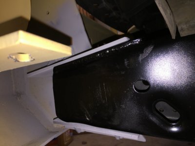

Yup, you're right. I was actually hoping to try to mount mine to the existing mounts at one point but I had already started cutting one off so just continued. Here's how I ultimately got it mounted... bolted to the frame, 4 bolts each side, 2 top, 2 bottom. Cut a decent sized hole on the opposite side of the frame to get the nuts onto the bolt. It's a bit of a challenge balancing the nut on the tip of the finger to get it onto the bolt. Bumper isn't going anywhere :).
