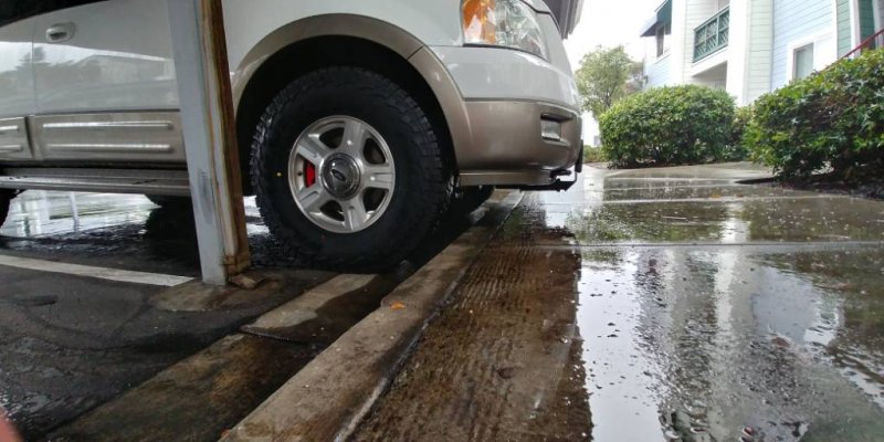

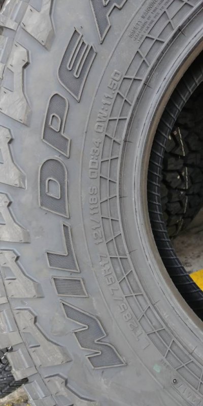

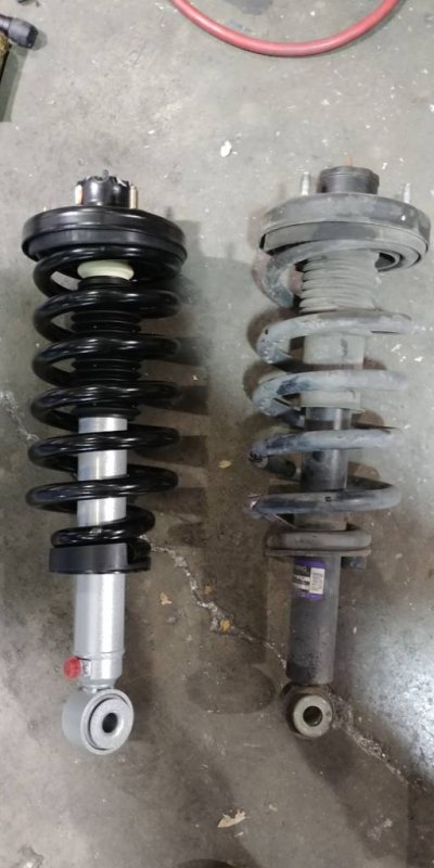

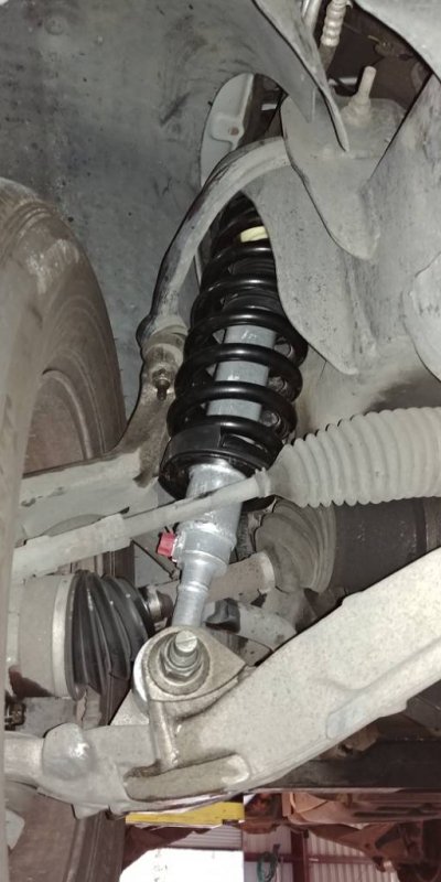

Finally got the Rancho quick lift done....just about 2" lift but wow it rides nice!
Now....tires.....a1ccacf051f4de4728fa35405fb85404.jpgb841c03ec1dd109683d848719a64ad70.jpg63870b4e6957a323631dbc0667f0cfd2.jpgfcfb29a22df280472a6c6698b99215d1.jpg
Sent from my LG-H872 using Tapatalk

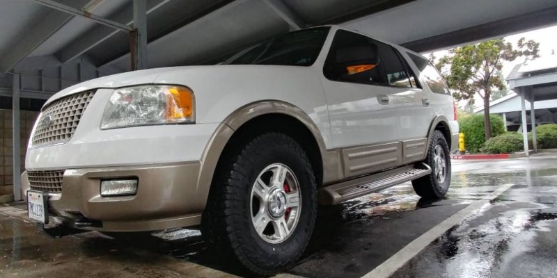

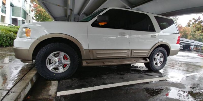

Tire shop - done [emoji818]
I'm a happy boy today!
Falken AT3W 285/75 17
5861c329315d3654ace201bb35542f3f.jpg4143fb9eecc088bf1209440daa458cec.jpg915f7ec8c69004b246570346cef0a9d5.jpgb9904fd6c9deac87a5449f2cef4abcf9.jpg
What settings are you running on ranchos with LT tires? And what are you inflating the LTs to?
