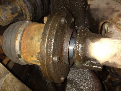

I was replacing the cv axel and when bolting in the cv axle I noticed it pulled right out so I pushed it back in. I was reading on google and people are saying the snap ring or c clap must have fallen off the end of the axle inside the differential were all the gears are. Is it going to be hard to get this clip back on the end of the axle??? HELP!!!!!

If you're lucky it's just a broke snap ring and you can push it back together and insert a new snap ring. Look on page 427 of the service manual for a blow up diagram of the front axle and instructions.
If you want to go ahead and buy a new snap ring they have 'em at the dealer or you can find them on eBay. It looks like it lost a lot of gear lube, so inspect the whole ring gear for damage, and refill the axle with lube when you put it back together.

so that picture is from online it’s not actually my truck but it’s the same exact problem. Only mine isn’t leaking anything at all. Thank you so much for your time. I’m going to look at that page now

If it looks like that it should've been leaking gear lube. Or maybe that's what caused the snap ring failure. It didn't have enough lube in it to begin with. When you put it back together make sure to fill the axle to the proper level with new gear lube.

The service manual download works fine. I think you need to take the Expy to the shop.

May give you a starting point and some heads up on working in this location. I lost a c-clip on a rear differential of a Ch-vy Bl-z-r before trading it in. Almost lost the axle and tire if it weren't for the rotor holding it in.
Get a new clip and check the axle end for the step wearing off. New gasket for the end pan. Plenty of fluid, harbor freight has a cheap hand pump to get the fluid in the filling hole, bottle won't fit in with the steering parts in place.
