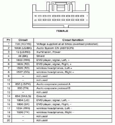

This might help. What is you need to do is loop the dvd audio to the IR headphone. Make a loop or us a jump wire to each Left +, - and Right +,-.
the OEM dvd is sending audio out to the OEM head unit and then back up to the IR headphone. look at the chart and make your corresponding links.
this pig tail is in the DVD unit. you need to take it down its held in by 4 screws and corner metel clips.

dtd07: thanks that helps a little. At least now I can get the headphones working.
