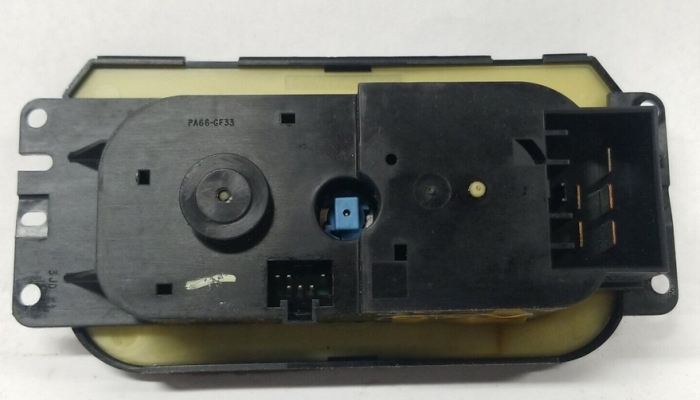

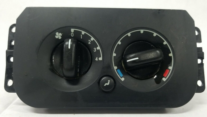

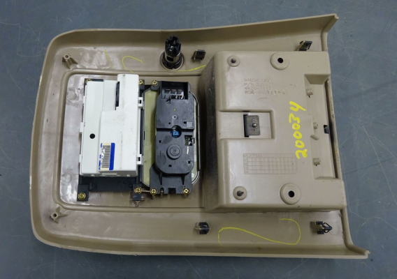

Okay, so now that I have seen the panel that looks like mine, screen shot below, I have an idea. I'm gonna say that it either is secured from the back of the trim, from inside the console or it just snaps on like most of the trim. I think pulling the inside of the center console out will show you if there's nuts or screws that hold the trim on from the back. If not it must be just that it snaps on.
All that said, I'm not sure you're gonna be able to replace the lamps, see the back screen shot below.

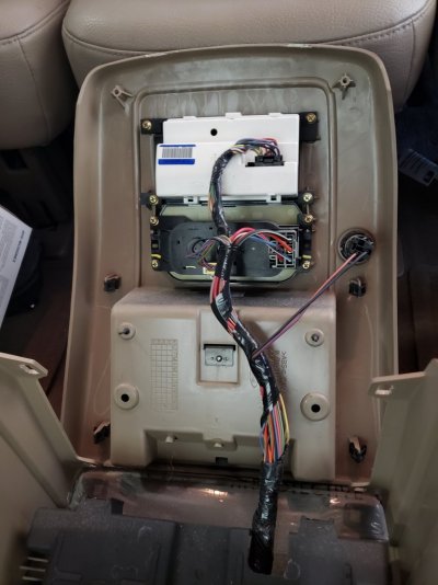

It doesn't just pop off, the center console liner has to be disassembled to get at that. I've never looked into those but I would be willing to bet those are a surface mount led for the lights as opposed to a normal bulb.

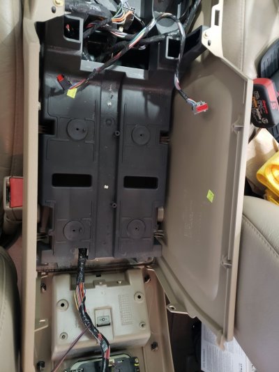

In the pics we had disassembled it to more easily run wiring for the radio and such. I installed a knockout panel inside of it that has connections for HDMI, AUX, and a couple USB ports. It could have been without doing it but made wire management and access with a dremel easier to cut the slot into the housing of it.
I also some spare sound dampening material on the outsides of the black plastic so it's sandwiched between that and the tan outer shell. Now if anything bounces around inside the console it's pretty quiet. No more hollow plastic sound!
If I were sound deadening the floor I'd probably go to to the effort to remove it if seats are also being pulled and have that much more access to the area. You're doing significant work as it is, an extra 30min of effort will improve overall access.

Yeah, I think those are replaceable units only and heat sealed, no screws in control units.
