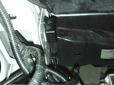

This first pic shows where I installed the ballasts. This side shows the passenger side. Both ballasts fit side-by-side on the frame rail using some industrial strength double sided tape (just make sure you thoroughly clean this surface first obviously). The small black wire going to that bolt on the left is the grounding wire for the H13's to control the Hi/Lo functionality. When I removed the bolt, I cleaned and brushed off the surface to make sure I had a good ground connection (i.e. no paint). The driver side is exactly the same setup.

Just FYI, there have been problems with DDMs bi-xenon control box. People start getting flickering when they hit bumps and what not. Make sure it is nice and secure, and out of the weather, if possible.
I don't have bi-xenons, but I still carry a set of halogen lows, in case my HID kit ever fails. Not sure how hard it is to take out the headlights in the 07s, but it's a thought you might want to consider. I know I read of at least one person where the control box wouldn't work, and they had to drive home with only fogs.

I didn't know that but I think I should be ok, thanks for the heads up. The spot I chose should protect it well enough and the relay itself is weather resistant by design. As far as taking the headlights out on 07+ is concerned, it is just two screws and they pop right out.
