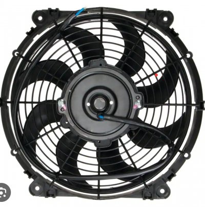

Ricco4592, thanks for your response. I referred the electric clutch fan as mechanical fan, which is mounted on the crank shaft? But I can see from front gril another small electric fan, see the photo of similar appearance. I can not find any fuse or relay detail for it. The AC works fine while driving, but at stops the cooling is less, I believe this fan should run on AC pressure switch, but need further detail to trouble shoot.

Motorcity muscle, you are right, the original doesn't come with electric fan, today I got a chance to visit a dealer for service and checked in the system, sounds one of the previous owner has retrofitted a fan to improve AC cooling. I will check actual wiring and see if I can get it working. Thanks

Jamicajoe, i examined the wires today, interestingly it seems to be via original harness, and the mounting is perfect like from factory. I will further examine when I get the factory wiring manual I ordered. I have seen explorer too, some with 2nd fan. For 2001 you can easily install one. I will try to share actual photo soon. The fan should be started and stopped via a high pressure switch at inlet of condenser, you can add one easily I hope. The switch has hysteresis to cut in and cut out so that an external relay can drive the fan.

I installed 2 electric fans on my '07 on the front of the condenser. They are wired to a pair of relays (one for each fan). The relays are triggered by the AC compressor clutch wire. I used to work in northwest Mexico and I would cross the border daily, often waiting in the border line for several hours, at idle, in >110'F heat (but it was a dry heat :cool: ). I also did this on my 2001 Expy back in the day for the same reasons, but that one also had a temperature sensor that was wedged into the radiator fins in addition to the AC signal line.
