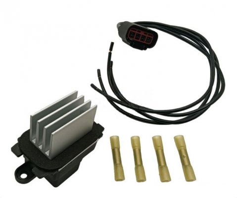

New to vehicle and forum. Hello all. Got a 2013 Limited to do some towing I need done. Renting was proving to be weird due to limitations on periods of time and costs. Will address that another time. Took an unladen trial run recently from Arizona to northern Montana (the route I need to do the towing). Very nice vehicle. I am not into things this large and expected...well... issues with 'largeness'. I experienced very few. It was flawless, ran and drove perfectly until our return (3,000+ mi later) when suddenly there was no AC. Nothing on the climate control panel at all, it wouldn't allow us to even run fans for outside air or anything. However, the rear AC worked. Set it up for a visit to the dealer and low and behold before I take it to the appointment, a day later the AC works. Took it anyway because I'm not going to live with a system I can't rely on. Dealer tells me it's working (duh) but that this issue is likely "the control panel" itself which of course in not available. Ok, I look that up and find only these HVAC Blower Motor Resistor (or kits) EVERYWHERE I look. As if it's a common failure. I see no one offering the dash control panel anywhere. Has someone experienced this type of intermittent AC issue?

I replaced my resistor and harness a few years ago and it has been good ever since. When I lost my front fan, no matter the setting, I could wiggle the plug and get it working again. A few of the contacts were burnt. Mine is a 2014 EL LTD, and I absolutely love driving it.

Got a call from the dealer. They took my advice and looked specifically at these components. They found the contacts looking burnt and the resistor looking....can't remember his words, but it looked fried. They're doing them both under warranty. Figures of course since I already had the kit on order and it's in transit....

It is a very known issue. The dealer should have checked the harness connection on your first visit. It only takes several minutes to check it.
At least the issue will be repaired.
