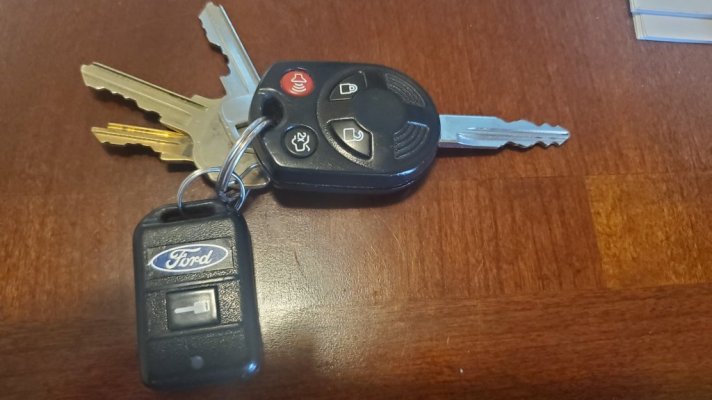

As others have said, look for the antenna shown in pic #1 somewhere on the windshield. If you have one, you have remote start. Also, on 2014 and older gen 3 trucks, the FOB for remote start is not part of the key which has all the other functions on it. It is a separate FOB that is shown in picture #2 below. If you purchased the vehicle used, the second FOB probably got lost somewhere in the shuffle and you did not receive it.

Evidently, there are multiple versions of this Ford OEM remote start system, some with the separate FOB, which I pictured above, some with a different version of the separate FOB and some with the RS integrated on the key. I have a 2011 and had a 2014 and both have this same model separate FOB and both were dealer installed.
I have the install document that covers a number of dealer installed versions. If you PM me your email, I'll send it to you.
