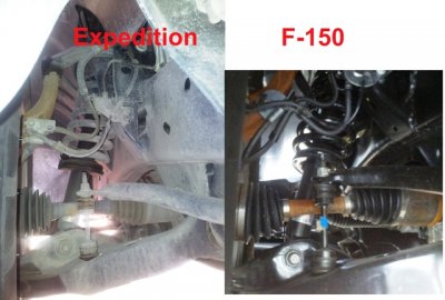

Anyway, maybe you can help me with this two:
1. I want to replace the steering knuckles, as I said.
Does the 2007-2010 F150 have the same front suspensions as our EXPY? Are the steering knuckles exchangeable from one to the other, so I could use “lifted” knuckles for the F150 in my EXPY?

The front suspension is something that Ive looked into before. I read somewhere that it was the same but then I started researching and found it that it was not. The part numbers were different. I even called a suspension company (cant remember which one) that had developed something for the expy and they say that was different.
Well, with my experience with land rover parts, I have found that different part number is not necessarily means different parts.
Some of the engine parts of the 4.0L Discovery (1999-2004) and the 4.6L (1999-2002) have different numbers but they are exactly the same and interchangeable – and it goes for the height sensors of the Discovery II (99-04) and the LR3/4 too – same parts different number and price (price !!!).
I think I’ll try to find a used F150 knuckle and see if it will “go in” and if it will, I’ll try finding lifted ones…

Hi Bernard
Good job and very nice looking Expedition.
Regarding the Knuckle I find that the expedition part is the same F-150 RWD the part number is :
MEF117 (Front Right)
MEF119 (Front Left)
And the F-150 4WD part number is :
MEF116 (Front Right)
MEF118 (Front Left)
Thanks
