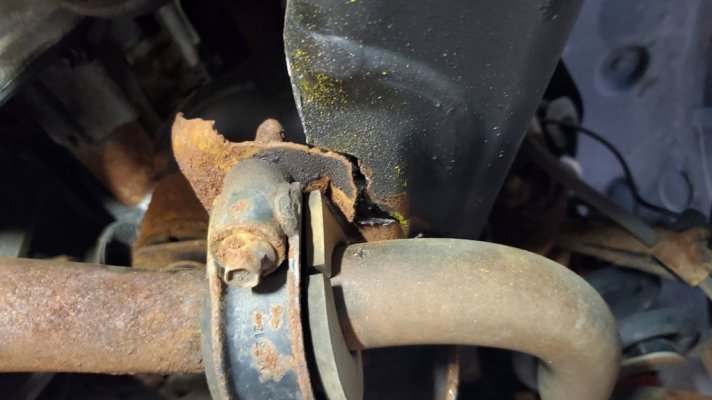

Never touched salt water. I bought it new and I don't have a boat.

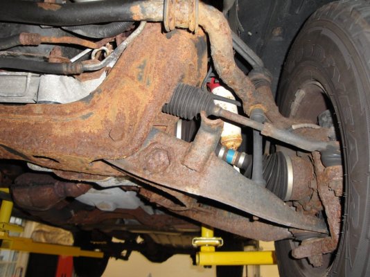

I blame the salt spray on the roads. That stuff sticks. After a snow drive I get to the car wash on the first dry day and get the undercarriage wash. Still, if I wash it again later that white spray still comes out.
That is exactly what happened. About 15 years ago, state DOT’s and local highway departments in the northeast began “pre-treating“ roads with liquid calcium chloride. The idea was to keep ice from forming on the roads at the beginning of a storm. While it did help with safety, it has destroyed the chassis and drivelines of hundreds of thousands of vehicles in the areas using this practice. Even the highway trucks that dispense this liquid have much higher component failure rates than similar age plow trucks that do not. Salt is bad, but the liquid is much worse as it gets EVERYWHERE.
I've been googling truck maintenance. As you would expect the industry tracks this stuff carefully because of $$$.
State by state when they switch to the calcium chloride spray they see a huge increase in parts failures and corrosion.

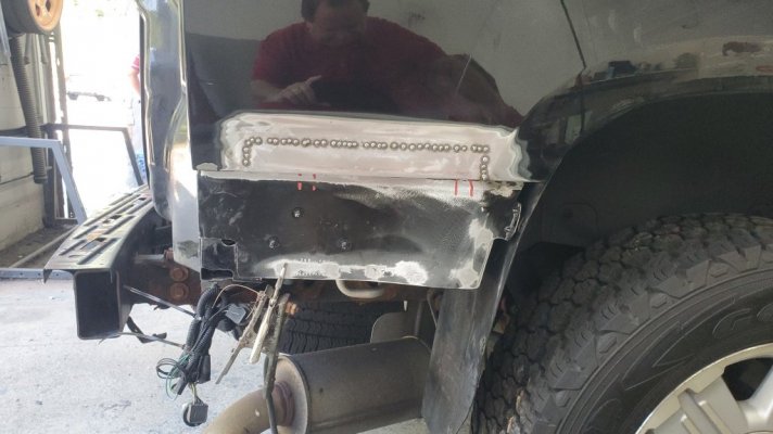

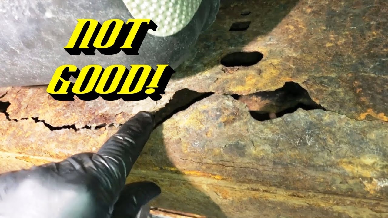

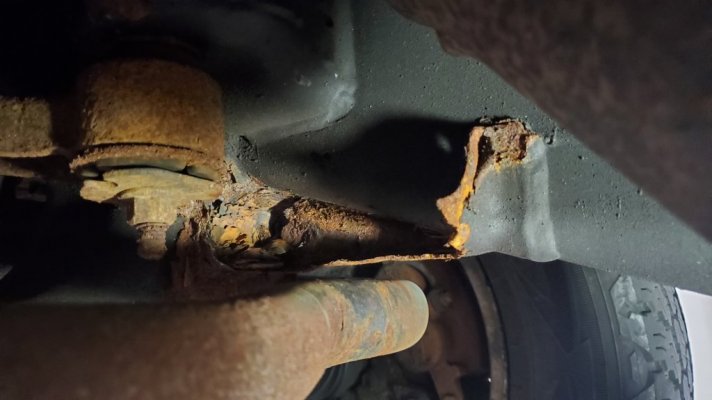

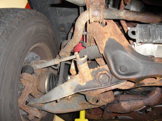

Of all of our vehicles (4 SUVs) we tried to only use the 2 older ones during winter months, especially during storms. The 2 used most during winter got damaged badly (nothing like yours) while our other 2 SUVs are pretty rust free and are no longer used in the winter at all.
98 Explorer 46,000 miles - Replaced Rear spring shackles, Fuel tank filler tube, all brake lines, all power steering lines, brake backing plates, front and rear bumpers and bumper brackets. Sold it rather than try to keep up.
2007 Tahoe 81,000 miles - Replaced inner body shell behind rear bumper and 4 shocks for second time. Currently in the process of replacing the frame sections supporting front sway bar, the front sway bar and all related hardware, both drive shafts and universal joints.
Tahoe 1
Tahoe 2
Tahoe 3
Explorer 1
Explorer 2

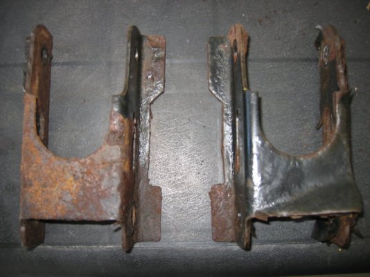

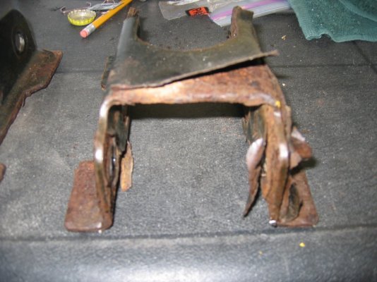

Can you imagine it fully loaded at high speed hitting a pothole? Top picture looks like it's ready to break in half.
That is ALL I can imagine now that I have seen it. This is our vacation vehicle. It could easily have failed with the family and all our festival gear going down the road at 60.
The reason I had it checked was "Steering wheel suddenly crooked while driving straight" and "Suspensions feels sloppy".
It is very fortunate I am picky about those sorts of things and SUPER lucky nobody was injured or killed.
