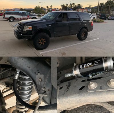

Your rear coils work with any of the 3rd gen Expys. I actually picked up some ‘09 rears to swap with Bilstiens, which I put in my 2015. Swapped perfectly. I had Nivomats before and wanted to get away from those, which is why I had to find donor stock rears. The fronts are what changed.

You misunderstood, the bilstein set up was what I had prior to the icons. I’ve had the the rear icons for about 7 months now and the fronts for about a year.
The rear coilovers will fit as a direct bolt on.

Nice Expy, Aces! Which Icon's did you end up using? Icon only lists coilovers for Expeditions year 2014 and on, so just curious which set you ended up going with and what, if any, mods were needed to get them to work.
There was a 2007 Expedition with Icons as well (Adventure Driven) so they must have used F150 coilovers. I believe they had to add smaller spacers down at the shock mount.

Thank you. Mine are the ones they have listed for the 14+. It’s a direct bolt on for our 3rd gens.
Adventure driven had theirs custom made by icon.
