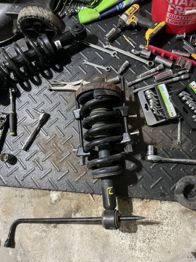

I will make a thread on this I think, here are a few photos of the rear bilsteins.
And the front:

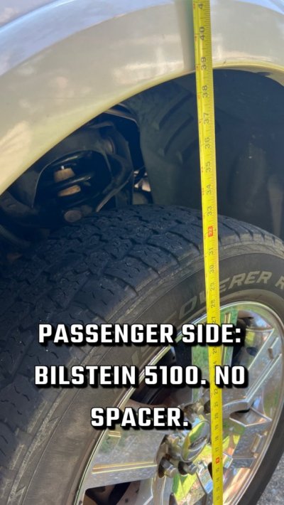

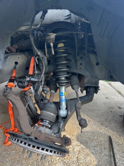

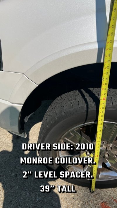

I have the shocks set to the lowest setting. Once I first put the passenger front on, the truck was the same height as a stock shock with a 2” spacer. After driving around town the front settled down 1 inch. There is a very slight rake but I have the shock at the lowest setting. The highest is 2.25”.
