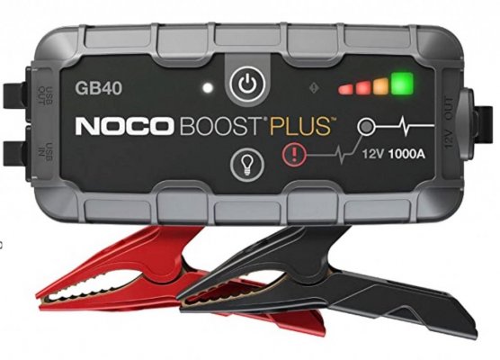

Something like this will not let you reverse the cables, will warn you and not apply power unless the cables are connected correctly.
