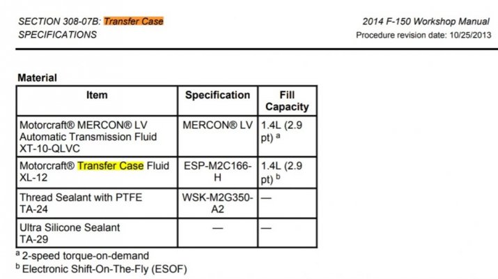

Short answer is yes as long as they used 1.4 liters (2.9 pints) of Motorcraft® MERCON® LV Automatic Transmission Fluid XT-10-QLVC
Long answer is that the F150 uses the same transfer case from Borg Warner (BW4417) but there are 2 different configurations, and yes they use the same volume of different fluids;
Electronic shift on the fly (ESOF) (2H 4H 4L)
Uses Motorcraft Transfer Case Fluid (XL-12)
2-speed Torque on demand (2H 4A 4H 4L)
Uses Motorcraft Transmission Fluid (XT-10-QLVC)
From the F150 workshop manual:
