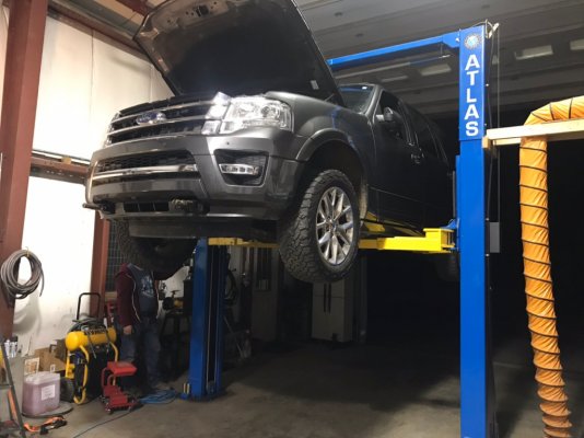

Last night we spent a couple of hours at a friends house. Went to get back in the truck to head home and had a significant lake of coolant under the truck with it dribbling from the skid plate. Put it on a lift to try and find the leak and couldn’t determine where it was coming from after an hour of searching. Will spend more time trying to find it but may have to ultimately take it into the shop. I absolutely love this truck, the way it looks, drives, how well appointed the cabin is with all the great luxury features and electronics. I love how quiet the cabin is. I love the Ecoboost power and fuel economy. I love the comfort and room. But at the end of the day, I can’t be throwing $3000-6000 into my truck at 130,000 miles. That just doesn’t make good math to me when I compare it to my previous vehicle experiences. I’ll likely be listing this truck for sale at some point over the next year or two and I probably won’t be back in the Ford camp for the foreseeable future. I just drive way too much to have my truck pooping out on me constantly. It’s been a good run.

I remember when you joined and you have documented issues/causes better than most. To be honest Muddy, You seem to have gotten "a bad one"; you have had more issues than most here, maybe more than all here with a '15 & later Gen3.
I do not drive distance the way you do but completely understand about needing reliability....and you "should" have had it in your expy....just sucks that it hasn't.

Muddy I wonder if the Lake of Coolant is from your other turbo that showing signs of going bad? Hopefully it's not leaking from the one that was replaced.

So my turbos are not leaking the coolant. The water pump area is dry. I can’t for the life of me find where it’s puking from.
Well, if you're losing coolant, and it ain't dripping, there's only one other option.
Head gasket.
What does your oil look like? How about the inside of the oil filler cap?
