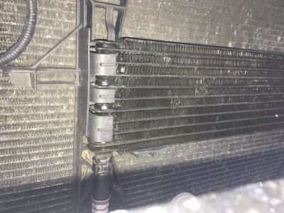

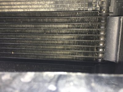

nater
Sep 22, 2019
Colorado
I highly recommend the larger trans cooler, part number
DL3Z-7A095-B
You will need to cut the top hose exactly 2.5" but otherwise it is a perfect fit and has twice the cooling capacity.
Here it is mounted in my Expy:
