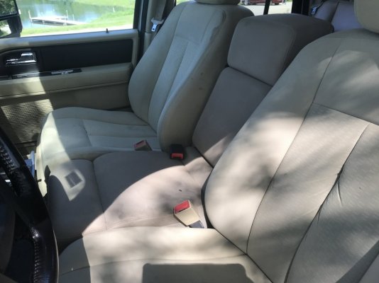

I did this in my 2016 EL SSV.
I installed a tan cloth one from what I think was a 2012 or 2013 F150 in a self-service salvage yard. But don't quote me on the year.
I took the mounting bolts along with. Some were only accessible after pulling the seat cushion up and off. The tan color was not quite the same as my 2016, but close enough for my purposes.
Two of the bolt holes in the rear of the seat lined up after I cleaned out the threads. The rear holes were so jammed with dust that I couldn't tell if they were threaded or not at first. I had to drill in some sheet metal screws to hold down the front.
I didn't install the seat belts, as I was not confident in its ability to hold up in a crash. So it functions solely as a center console. The extra cup holders on the top and back side sure are handy!

This is how it turned out. It’s not the greatest fit and finish but it does the job.
