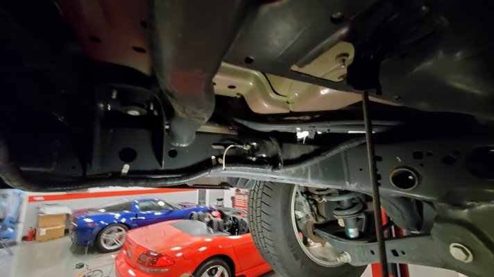

I also have a 17 with HDTow and pull an open car trailer with total weight ranging from 4900 to 6500. No issue at all with towing capability, even in PA mountains. Yes, you do need to adjust the braking pressure ramp-up based on weight you are towing. It is the up/down rocker switch on the controller itself.
I did have a strange issue with the controller not applying the brakes and declaring "trailer disconnected". Turned out to be the coupler ground which is above the spare tire and not visible unless the spare is dropped / removed.
Ground is the white wire attached to frame in picture below. Removed, cleaned / brushed connector and frame, reinstalled and all was well, but drove me crazy for days, checking everything and thinking it was the controller itself, until I decided to trace the wires from the coupler to the controller after checking all of the trailer wiring.
