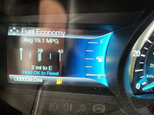

A couple of weeks ago I was in the middle of a 4,000 mile trip and decided to update my maps. I quickly found out that the maps would not install unless I updated the already installed sync 3 to the latest sync 3 version. After performing the sync update and map update I noticed that the gear selection icon is missing now. It used to show all six gears in the icon and it would show what gear the transmission was in at any given time. That icon disappeared after the programming. Not a big thing but I wonder why the change. It will show a single gear number in the tach icon but the old icon is now not available. 20230608_183041_resized.jpg

A couple of weeks ago I was in the middle of a 4,000 mile trip and decided to update my maps. I quickly found out that the maps would not install unless I updated the already installed sync 3 to the latest sync 3 version. After performing the sync update and map update I noticed that the gear selection icon is missing now. It used to show all six gears in the icon and it would show what gear the transmission was in at any given time. That icon disappeared after the programming. Not a big thing but I wonder why the change. It will show a single gear number in the tach icon but the old icon is now not available. View attachment 77993
Press the + / - button on the side of the transmission shift lever while the engine is running and the shift lever is in the drive position.
That switch will also toggle the display you’re now missing between the on and off display.

I’m sure whenever you manipulating one of the buttons (radio, a/c, etc…) you may have accidentally bumped the +/- button on the gear selector. I normally do it when fumbling with the a/c controls.
