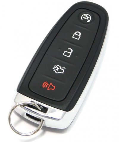

My '17 XLT didn't come with remote start. I wanted to add it but they told me $1000 extra and I would have to carry 2 keyfobs... I assume an aftermarket remote start kit w/it's own fob. I decided NOT to do it as I don't want to carry all that extra stuff on my key chain.
Do you think this would work for my '17? I am ignorant when coming to cars. So you are saying all I would need is the key remote you had the picture of and take it to the dealership to program it?
View attachment 23399 The dealer is full of crap on the '16 Expedition. All you need to buy is new factory remote start keys...which look just like the original but with the center start button....the dealer programs the PCM with a laptop and you now have factory remote start. No cutting wires and plugging in stuff. Then you end up with 4 keys for your truck, 2 remote start 2 regular.
