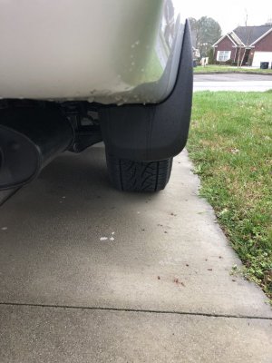

Do you have to drill holes for either the Weathertech or Husky mudflaps?
Husky - you have to drill a hole for the rear mud flaps (I have the fixed running boards, so the front ones fit perfect. I'll try to take a pic when it stops raining here.
