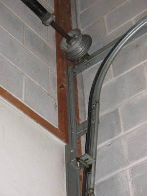

Your garage door opener has a limit switch that needs to be moved. Super easy. Usually its on the rail and it just needs moved closer to the opener. The bottom section of your door isn't going in far enough, leaving the bottom door section hanging too low. No need to replace the door, track or anything else. 100% DIY, no need to pay anyone to do anything.
The difference between those two photos is the height of track when it curves to the horizontal. You'll never get the door higher than the horizontal tracks.
The switch certainly plays a big role, but you also will have to take into account the coil spring, in particular the pulley(s) location. If you move the switch too far back, at the end of the cycle the motor will begin to pull against the spring (pulling the cables off the reel as the door bottom moves away from the 'vertical' and into the garage.
This photo is a high lift system and not what you'd normally see in a home, but you can see the distance between the wall and the spring rod is set to keep the cable vertical. In your home, the rod is very near the top of the door opening. There isn't a lot of adjustment available, but its something to keep in mind. If you pull the door in too far, the spring will always be trying to pull it back out. Luckily, the torsion on the spring is at its lowest when the door is up, so it's not a huge pull. Moving the spring/pulley farther away from the wall would help.

3) Most importantly, like I have explained in my OP and later, the construction of that garage door and garage space is a little quirky, in that there is low headroom available on the wall above the inside of the garage door. The garage door technician who had come in explained that to me and said that is why they had to go with a dual track system which takes more space and ends up keeping the opened garage door hanging below the brick and mortar opening/ clearance. This is the most important point to note. It is simply not possible to gain all the clearance that the brick and mortar opening allows even if the track travel time is fully adjusted and the garage door opened all the way up. It will ALWAYS hang below the top of the clearance. That was the biggest hindrance.
4) Another minor problem is that the garage door floor is raised a little to help avoid flooding, so when the tires hit the stepped-up floor cars usually bounce up a little, thus making it more likely to hit the garage door trims.
5) Funny enough, it only hits the horizontal trim and not the garage door itself. The technician had suggested I remove that one trim but said it would impact the stability of the garage door in the long run so I decided against removing that darn trim.
