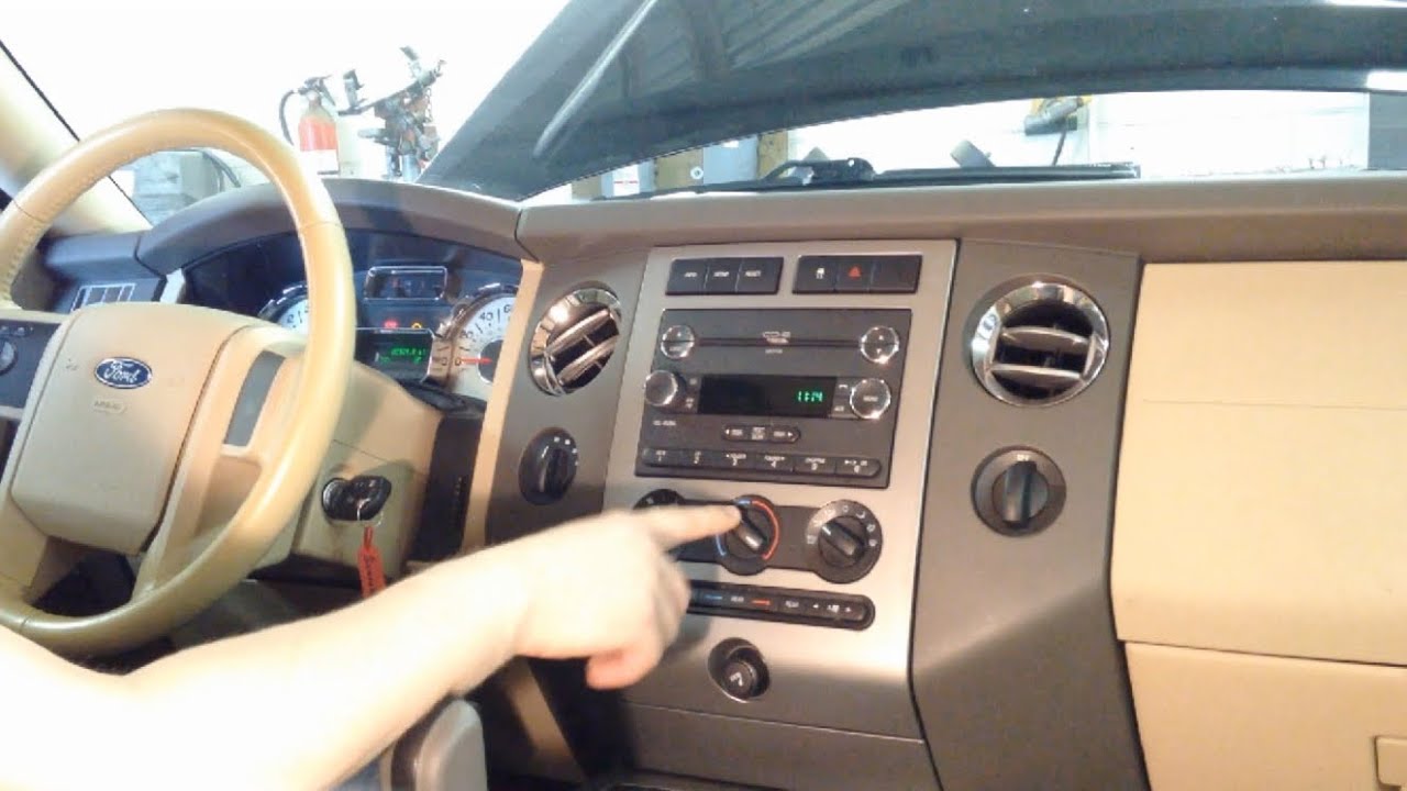

I did a quick Google and youtube search to see if anyone else has had this problem with no luck.
Had it blowing through the vents, no A/C button was on
Turned it to heat because it was blowing cold (like A/C cold)
Nothing changed, continued to blow cold no matter what I did...
Any help would be appreciated.
Sent from my SM-G975U using Tapatalk
JimR_TN
Oct 30, 2022
105
72
Middle TN
Not sure of all the steps for troubleshooting, however the temperature blend door actuator is a likely candidate. They sometimes click before going out, at other times they just stop working.
