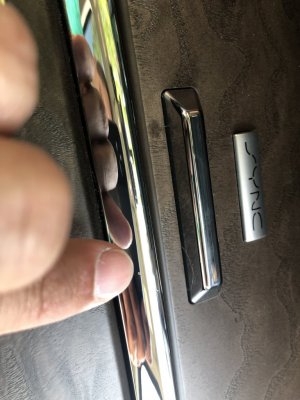

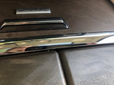

Then the biggest of all.... when looking closely at ALL THE CHROME( all window trim, electric step trim, roof rail, rear trim, and the rear expedition chrome plaque) has small chrome pitting all throughout.
I took it to the dealer to address with having less than 40miles on the clock.
While there they verified everything, and upon further inspection of ALL the expeditions on the lot... all the chrome trim regardless of model has chrome pitting. This included the 87k platinum max whoch even had pitting on the chrome mirror covers.
They'e currently addressing and replacing all the issues, but inspect you chrome trim closely as this is likely a major supplier defect many over look.
