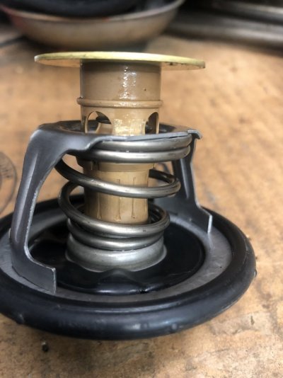

I had the same exact problem. It would even do it on a 40 degree day at highway speeds and the heat on! After being sure I had no coolant leaks, radiator shutters were opening and coolant system was working, I pulled the thermostat and could see marks that it was binding on its shaft. FordBossMe on YouTube has an exact video showing that Ford has an updated T stat for this problem.

Update my case: Ford dealer initially change a new active grill shutter and told me it is fixed. Unfortunately it is not. Then they replace the thermostat and fix the issue.
