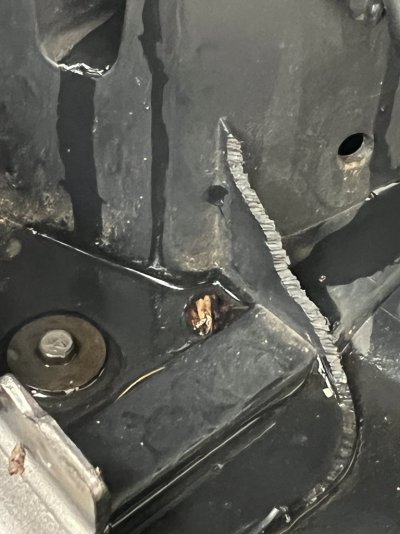

What did your ins co say? Doubtful rodent damage is covered under warranty. Dealer should give you an estimate to replace the damaged harnesses (the ones that can be seen) and ins should cut a check for the initial amount. Then cover any overage after repair is complete.
Insurance said it would cover after deductible of $2500.00 But the dealership hasn't said much about it being rodent damage... Said they can't find any other damaged wires. They just keep talking communication module.
