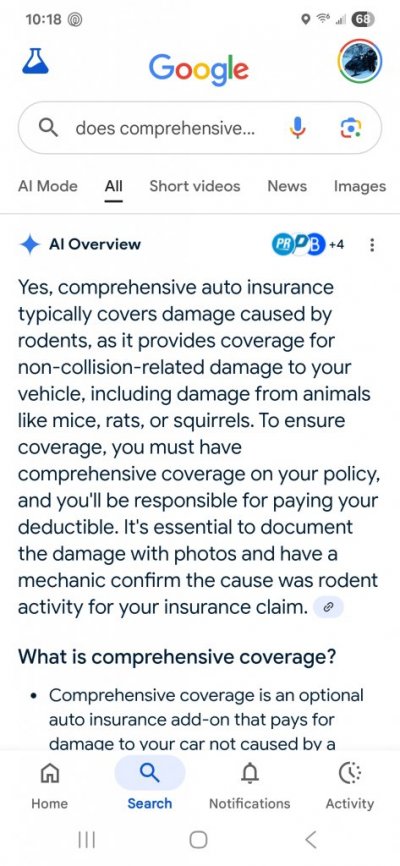

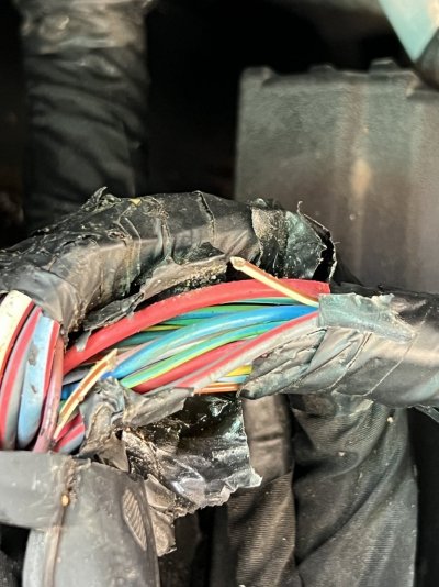

As I mentioned above.. This sure seems like rodent damage to electrical wires (especially given the pick you posted of chewed plastic). Your insurance should cover this under Comprehensive. Screenshot_20250825_101814_Google.jpg

Something has chewed through your wiring. You found two areas, but there could be many more.
Only a dealership (or a good mechanics) can fix this, and I'm afraid it probably won't be cheap.

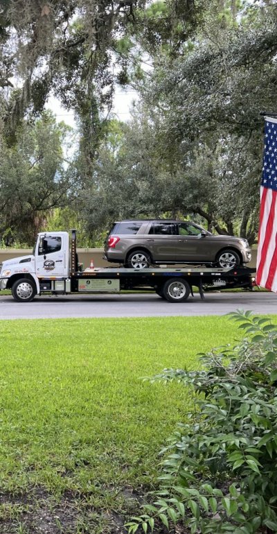

Just an update, She was towed away about a month ago. It sat at the dealership for 2 weeks in the same spot.
They finally started working on it about a week ago.
Replaced the fuse / Junction box.... There is a recall on that, I had no idea about.
Called and said still no communication at all.
Asked for 5 hrs of diagnostic time. $240.00 hr.
Called again Yesterday wants to replace the "Communication Module?" Is that the OBD2 port?
Said He got me a discount for Labor Hrs $140.00 Hr.
I asked again about replacing the CPU he said it would be covered under the powertrain warranty (71K miles on the car)
But he wants to check the modules first, and none of those are considered powertrain, so not covered.
