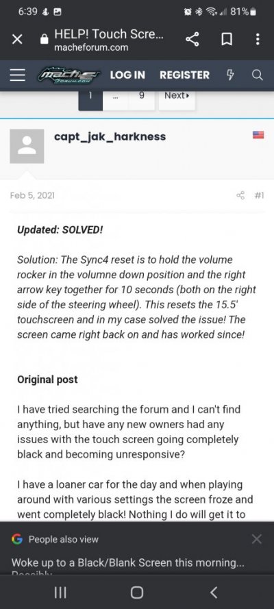

Our 15" screen went black today. Performed the below reset and it came back on. Whew!
"On the steering wheel hold the SEEK FORWARD and VOLUME DOWN at the same time."

A few people have shared how to reset the screen. And that definitely works for minor issues and screen freezes. And it worked the first time mine went black. Then my screen randomly turned the audio off and wouldn’t come back on no matter what I tried. Then it started showing 4x4 drive problem codes. Those went away after a car restart but I could sense the car needed something fixed and a screen reset wouldn’t do it. And sure enough the cars sitting at the dealership and here I am waiting for a back ordered part and without my brand new car.
