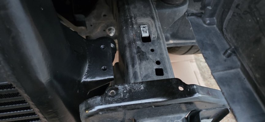

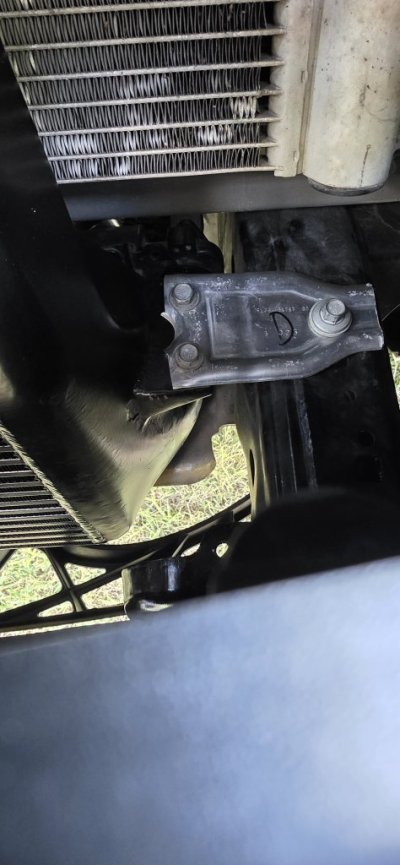

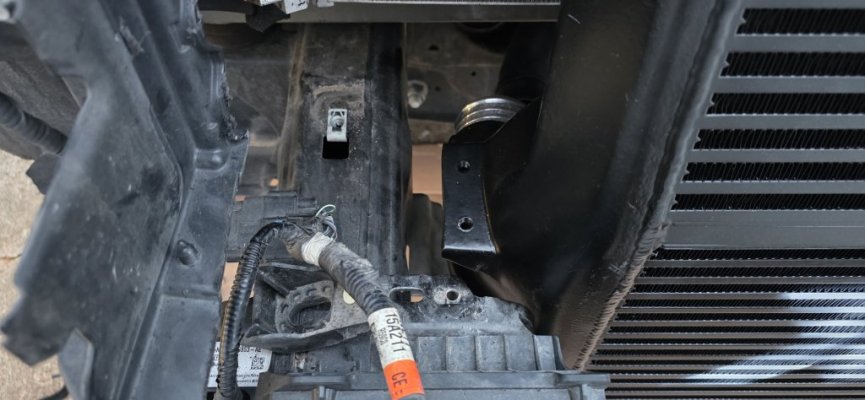

Pretty sure I'm the first to do this on a 22+, as I haven't seen any threads on it - but regardless.
I saw this intercooler: https://www.ebay.com/itm/187856664379
And thought, why not - it's the same body as the rest, just add on the top-part.
The rest of the forums talked about having to trim the radiator shutters (yep, still true)
as well as needing to remove the intercooler shutters (also still true)
But I'm happy to report that as long as you can break it down, you can make this big boy fit in there.
I did move the lower support bracket ahead one-slot in the frame (pictured)
Gonna finish buttoning everything tomorrow and putting on new hot/cold pipes.
Wouldn't mind if anyone wanted to throw out how I should secure this thing on top; thinking of butchering the top bracket and using the two bolt-hole (ear tabs?) on the intercooler (pictured)

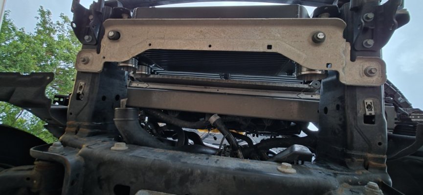

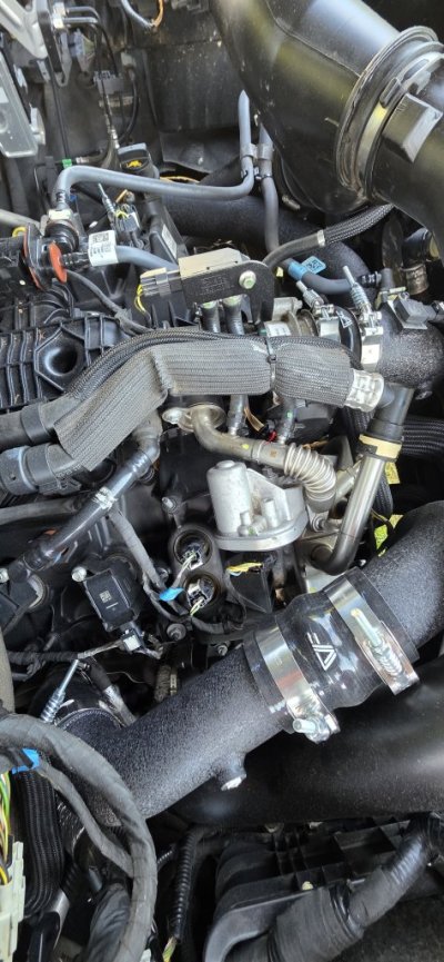

I would tend to agree - that's why I did the CV Fab Hot and Cold pipes. Good god this thing claws it's way up to speed now
I am interested in tuning it - Not sure the best route to go there
For now I'm doing heat management stuff: B+M trans pan, trans cooler, trans Heat-Exchange delete, thermostat and 2" radiator
Love these EB's and have been waiting to get a gen 3 but it gets hot AF in summer here and they already produce a lot of heat.

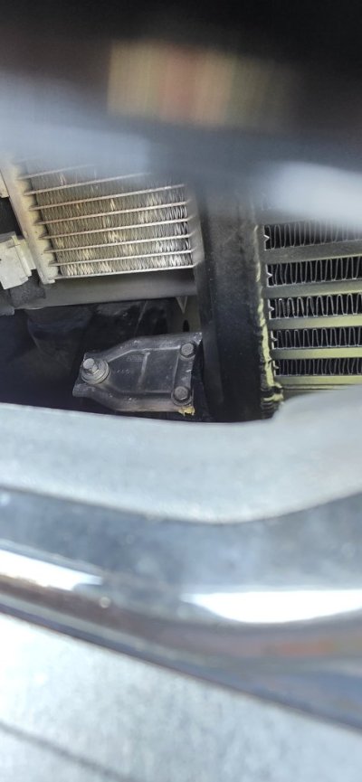

Will do buddy - thanks for the kinds words.
Caught the bug yesterday and did the B+M pan, filter, fluid, dipstick - long day, but very happy with the results.
Wishing the exhaust engineers would have worked more closely with the transmission engineers. Having to jack the tranny to get the rear bolts cost me +/- 2hrs for the "hidden" 15mm bolts that connect the trans to the frame; not to mention just a major pita.
Either way, all done - no leaks. Transmission adaption tables reset. She freaking scoots
