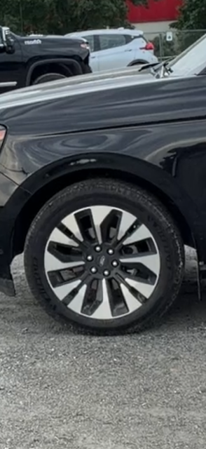

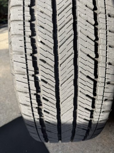

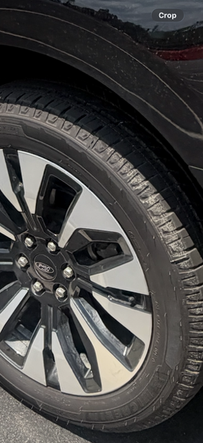

Good morning Lads,
Have a 2025 Platinum, with 22" Rims and Michelin All Season Radials, 275-50R 22, on 22" rims, pretty standard. Would you air these down to 15 PSI, hit the 4WD, and drive them on the beach to go fishing on the Outer Banks of NC? Or, should I invest in some 17"- 18" Ford OEM rims and get some proper A/T tires with more 'Teeth' for the sand?

Sorry, but I would have a beach rig not a beautiful Expedition to drive to the water. I have seen how fast beach rigs rust, or corrode away. Unless you buy a new rig every couple years.
SENC
May 6, 2026
30
SE NC
No need for AT tires, but you definitely want to air down and low profile tires aren't good for that. Some 17" or 18" wheels and Defender LTX would be ideal for these Expeditions, in my opinion, and when it's time to replace my tires that's what I'll be going to (from the 20" wheels on my KR).
rslynes
Aug 1, 2021
58
25
Wisconsin
22" (or even 20") tires really don't have enough sidewall to support the vehicle weight if you air them down. You'd end up with what they call a 'Pinch Flat' going over a sizable rock or edge.

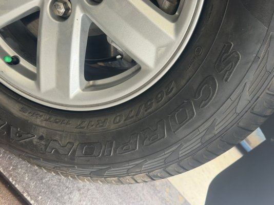

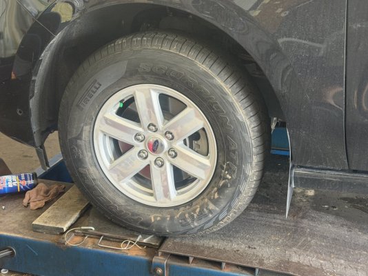

Lads, as suggested, I decided to search for some 17” rims and 265 AT tires. Then, I found a great supplier on eBay, a dealer just pulled some 17” spoke rims with Pirelli Scorpion AT Tires from a new F150 in TX and I snagged them! Just got them balanced and mounted up. Let’s see if these pics load.

It probably rides incredible with that wheel set up

As per this conversation, I decided to mount OEM 17" rims with 265 R70 17' Pirelli Scorpion AT Tires. They worked on the beach just great! i also researched that both 17" and 18" work great on the 2025 Platinum.
