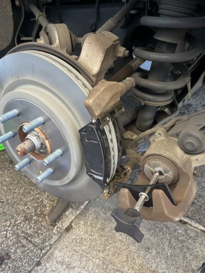

just had to replace rears at 58k! Driver side metal on metal I listen to loud music don’t judge. Also did the fronts didn’t need to but did anyways IMG_7492.jpeg
