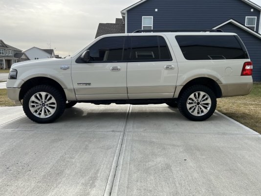

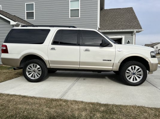

Does anyone have a square side profile image of this lift installed on their vehicle as well as any warnings associated. Thanks

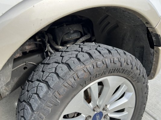

Mikezr
Jan 14, 2021
67
21
Canada
Had the 3 and 2 didn't like the end result and imo to use that setup it should have aftermarket control arms. It sure doesn't leave a whole lot of room for travel. Only thing gained really was clearance for 35s but the tradeoff wasn't worth it so back to 2 and 2 and it's about perfect

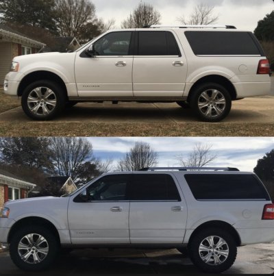

maxxplatinum9137
Feb 22, 2022
158
71
Washington
@Mikezr you said it yourself. All the kit allows you is 35s, you may get extra clearance too but without control arms and other components you’re not really gaining much. I had them on my 2016 platinum pictured above and at full extension they UCAs rubbed like crazy on the springs which I was not a fan of. All 4 tires get sucked farther in to the wheel well due to the pucks changing some angles so you’ll need spacers, more negative offset, or a wider tire for it to look anywhere outside of stupid. And the rear wheels are pulled forward towards the passenger doors. I purchased mine solely to put 35/11.50s on and also had 1.25” BORA adapters on the hubs. You can maybe take it on a trail or the beach but that’s about it. It looks good for sure, but performance is no where near what icon or bilstein would get you
