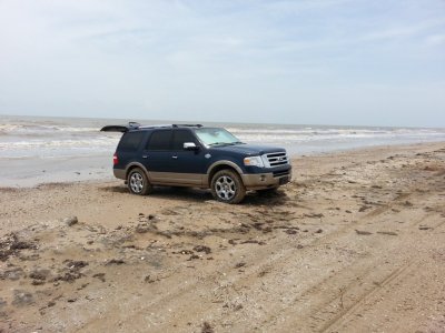

20150620_133555.jpg I ran 285/55R20 in both Michelin LTX AT2 and Toyo Open Country AT2 without even a hint of rub. Plenty of room between the UCA as well.

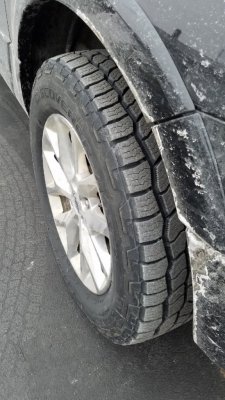

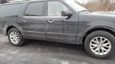

I'm running Cooper Discoverer AT3 4S in that size (275/60/20) - stock wheels on a '16 EL Limited no lift. *Edit: typo said 275/50 ... I'm running 275/60 or approx. 33x11.
I think I saw a guy on one of these forums running 285/60/20s ... aftermarket 20x9 wheels with more offset but his rig was also a Limited I think.
