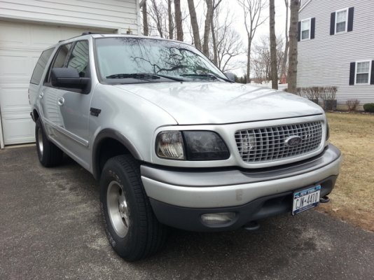

The end result is this. I think they look a lot better than the factory round mirrors and I feel like it gives a little better view than the old ones as well.
14,561
888
Hampton, VA
Looks out of place to me...nice right up though
